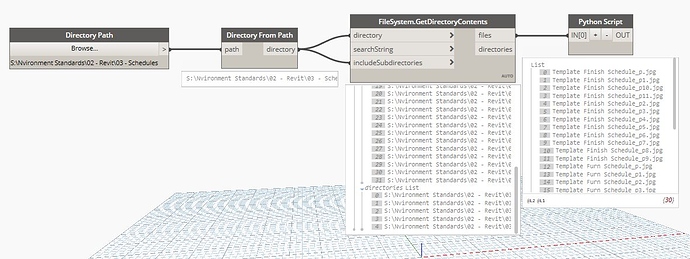

If you want to check the filenames that the code is reading from the directory you could try adding this to your OUT node:

Not pretty but it works just fine. The only thing is to make sure the file is saved before you run the script. This atleast reloads all the jpegs in the saved directory without manual pathing. If anyone has a cleaner way of doing it let me know. or away to autosave the file before
well I thought I had it but then I did it on a live project and enabled worksets. this makes you file local. so I used the node Document.CentralPath. and it looked correct, but once I run it it only reloaded 1 jpeg ugh.
