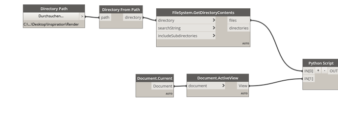

Is there any node/package that loads i8mages from a folder? i cant find anything. Thanks.
I am not awara of any package or node. Still the method is exposed in the Revit API -
http://www.revitapidocs.com/2015/493d203e-ef4c-b447-f979-52b22725b2ad.htm
You could write a python script.
Hope this gives you a starting point.
Something like this should work to import all pictures from a folder:

Thank you. I’ve got similar approach, but im not well on python. I’d like also to check if the image already exist in the project then dont import and continue if it’s not on the project? How do i do that? inside python?
There was an answer to the same question here: Is it possible?
thanks Konrad, Is there a way to see it in higher resolution?
Solved! Thanks guys! Found 2 solutions, 1 from PeterPpenchev1 , lucamanzoni & Konrad, (with view options) and one method from @erfajo (document importImage)
