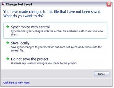

I’m using batch processor to run a dynamo file for more than 50 projects.
However, sometimes I get a request from my coworkers asking to relinquish elements / sync since I made a change in workset and they can’t move forward without my permission.
Its not all 50 projects are causing the problem - they are only few which I can’t really grasp the reason for these problems.
Sometimes when I run Batch Processor, after running a file, it throws a window like this
and doesn’t know what to do (Usually Batch Processor automatically knows which button to click in different situation but this is the window that BP doesn’t know what to do). In result, I think it just cancels instead of saving to central.
I do not want any of my coworkers to keep annoyed by this matter and I’m not sure what the problem is. Is it something that I have to do with BVN setting? I dont want to run them in detached mode.
Any advice or suggestion would be greatly appreciated. Thank you!

I just looked through and I am not a borrower of any workset. The problem is when I run the Dynamo script with Batch Processor, the Batch Processor quits without syncing or relinquishing. Do you have any suggestion on which Dynamo package I should use to add a graph that will relinquish at the end of running the script? so that BVN will close after relinquishing the file. or Does it require a python script?
