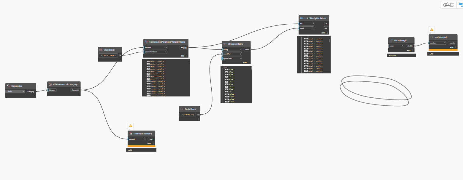

Hi everyone :slight_smile: I need assistance on how to quantify the total length of model lines (or detail lines) per level in Revit using Dynamo, specifically for a faceted glass balustrade layout. The objective is to:
  • Select and filter lines only from a specific level (e.g., Level 1).
  • Calculate and round off the length of each line segment.
  • Quantify the number of occurrences per line length (e.g., how many times a 1200mm segment appears).
  • Compute the total length.
  • Export all gathered data (Level, individual lengths, quantity per length, total) into Excel.
I’m looking for:
  1. Best-practice Dynamo node workflows (no Python if possible).
  2. Suggestions for clean data structure before Excel export (e.g., using List.GroupByKey or List.CountOccurrences).
  3. Any alternative methods or scripts that might better suit this task.
Appreciate if someone can guide or share a sample Dynamo script that works well for this kind of quantification and Excel reporting. uploaded herewith snip, Dynamo file and Revit file

try with this…
thanks bro, appreciated
