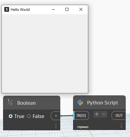

Hello, how are you, I have a query, can you change the .dyn files to .exe? Dynamo is very extensive and can be used, for example, in word, it would not be necessary to enter dynamo itself and execute it, it would be more practical from an exe file, I also have installed DynoSnapper.
would there be any way to make our .exe files?
clr.AddReference('System.Drawing')
clr.AddReference('System.Windows.Forms')
from System.Reflection import Assembly
from System.Windows.Forms import Form
from System.Drawing import Icon
iconFilename = r'C:\Users\D\OneDrive\Escritorio\rk\Example.ico'
icon = Icon(iconFilename)
form = Form()
form.Text = "Hello World"
form.Icon = icon
form.Show()
OUT = form
