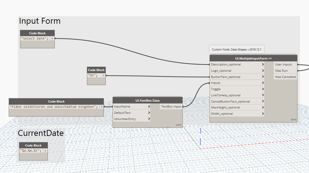

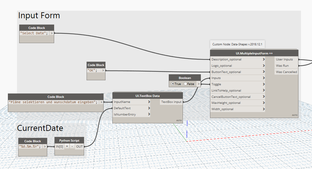

This is the same script, started on a virtual machine:
All Python Scripts, “List.Create” and all Boolean Toggles are deleted from the script in my virtual environment… The strange thing is, that I can create all these Nodes again in the script and use it. When I save the file all this info is saved and I can access it from my “normal” computer. When I reopen the script on my virtual machine, the nodes are gone again.

Can you provide the DYN from the non-virtualized system so that we can review the contents? Then try rebuilding the graph in the virtual environment and see if the nodes ‘stick’ in both the virtual environment and the standard one. The first test will allow us to confirm it’s related to the virtualization (anyone who opens the graph will have all nodes), and the second will confirm if it’s a one way issue or if it’s persistent on any opening of the graph in your non-standard environment.
I recreated the script on my VM and could start it on my normal computer. When I reopened it on the VM the nodes “Boolean Toggle” and “Python Scripts” were gone again. Seems to be a problem with the opening process of the .dyn File… When I create the script in Dynamo and start it from there on my VM it works fine.
