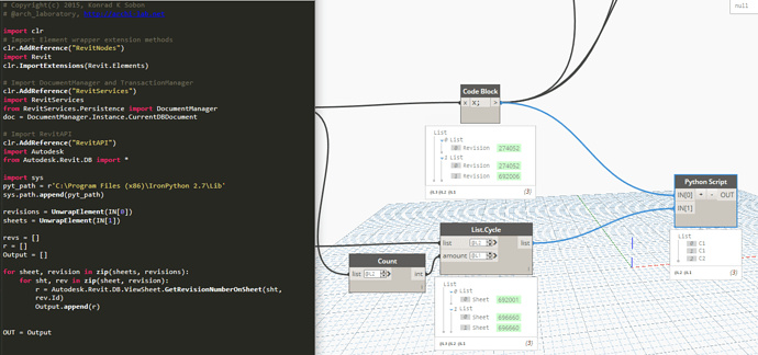

Hey,
Would anyone mind helping me control my output to match the input lists here?
I can fix it with nodes, but I would like to better control my python code :slight_smile:
(if there was a way of removing the need to list cycle the sheet input, that would also be cool!)
thanks Konrad et al!
# Import Element wrapper extension methods
import Revit
import RevitServices
# Import RevitAPI
clr.AddReference("RevitAPI")
import Autodesk
import sys
pyt_path = r'C:\Program Files (x86)\IronPython 2.7\Lib'
sys.path.append(pyt_path)
revisions = UnwrapElement(IN[0])
sheets = UnwrapElement(IN[1])
revs = []
r = []
Output = []
for sheet, revision in zip(sheets, revisions):
    for sht, rev in zip(sheet, revision):
        r = Autodesk.Revit.DB.ViewSheet.GetRevisionNumberOnSheet(sht, rev.Id)
        Output.append(r)
OUT = Output
test.dyn (10.2 KB)
Thanks a lot :slight_smile:
Mark

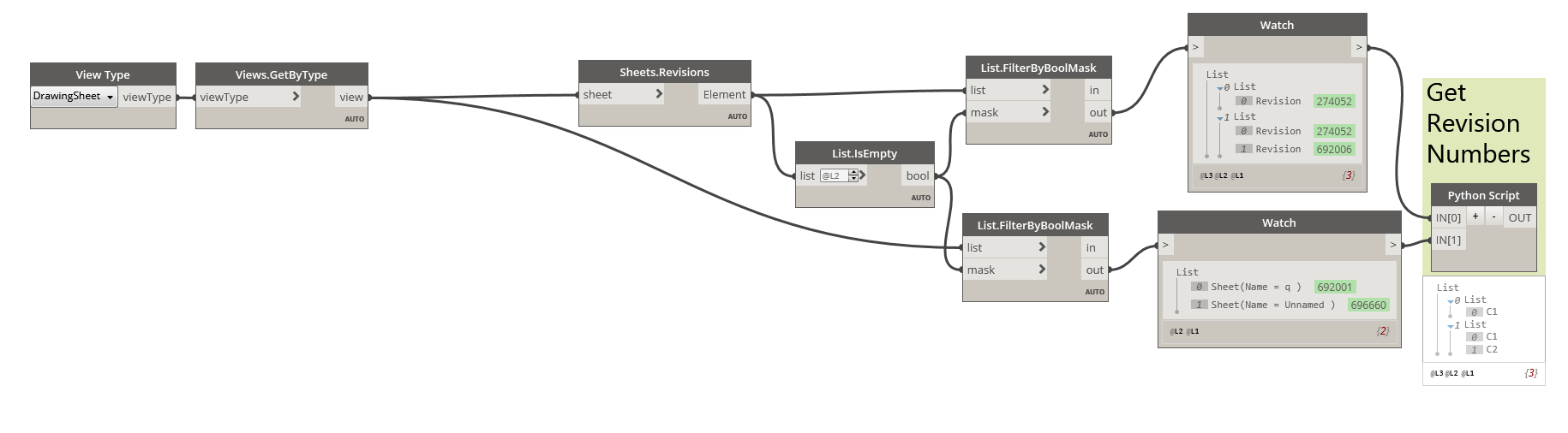

Hello. Can you give a sample revit file too? Or a dummy dynamo file that doesn’t need Revit
Sure, thanks!
test.rvt (1.1 MB)
Something like this?

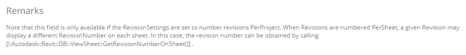

Hi Marcel,
Yes it is different if you set the Revisions By Project…
http://www.revitapidocs.com/2018/f46d2d49-1d37-6e99-f450-d21401fd848f.htm
You’ll see the method I’ve used in the Remarks…
I suspect that you can pull other info from Revision clouds, but I always have a Revision ticked in ‘Revisions on Sheet’ incase (when) someone deletes the cloud.
