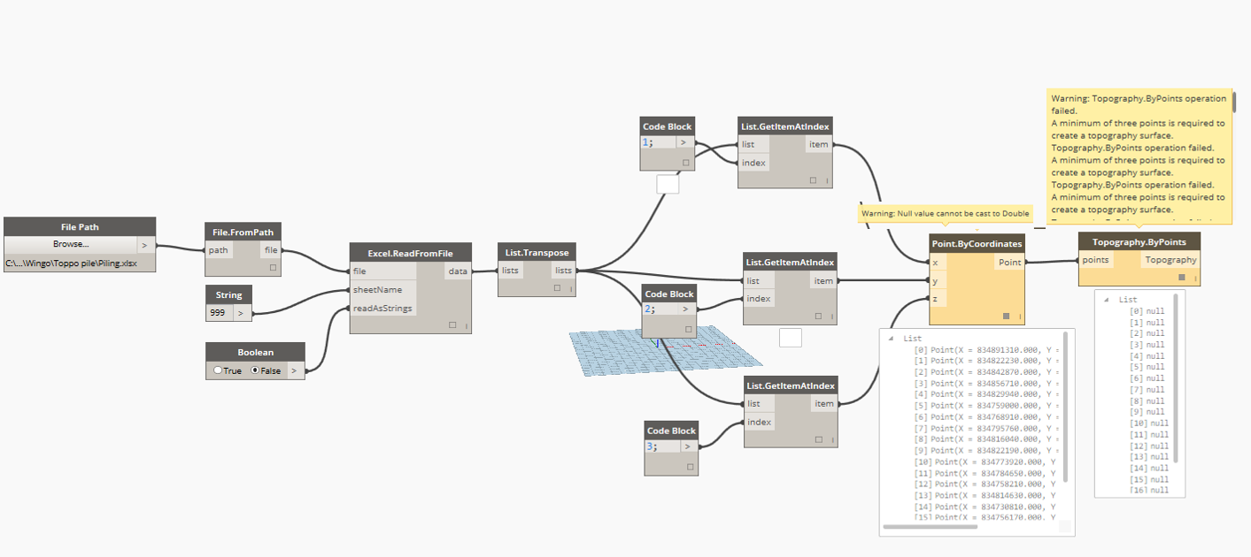

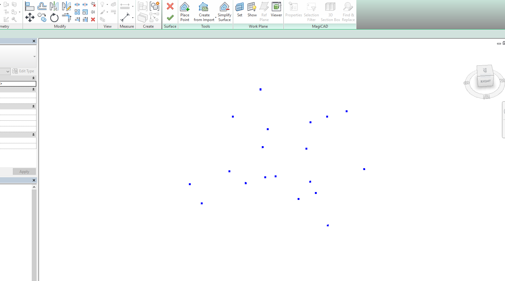

i am trying to create the topography form excel data through dynamo but i can not getting the topography in revit there only have some point like following:
can anyone help me on this issue? thanks
You seem to have some null values in your points list.
Avoid feeding a list with null values into Topography.ByPoints
You could do one or both of the following …
  • Flatten/Clean the Points list before connecting to Topography.ByPoints

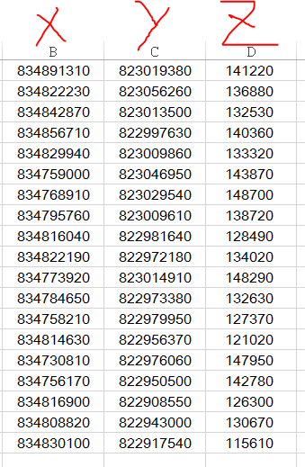

  • Ensure that X,Y and Z have the same number of valid numeric values in the excel sheet

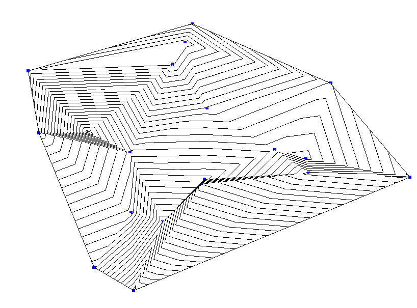

Success!!Thank you Vikram :grin:
