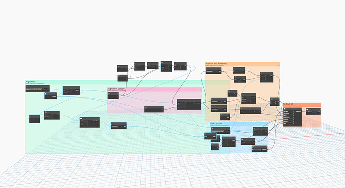

I have gone through this solution, but this is not working for me. I’m attaching some screenshot for your reference.
Here is the dynamo script screenshot.
Do you have any nodes that retrieve the cant data from the alignment to use for the rotation? Right now it appears that there is just a slider that apples a rotation of 0, which is why nothing is happening.
Slider is to rotate block at its axis. Could you please guide me which node i should use to get CANT information and linked with the block

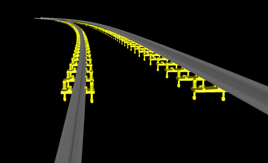

This should give you what you need:
Sleeper.dyn (33.6 KB)
try this dyn file
hey , could you pls share the dyn file its not be visible clearly that would be very helpful .
