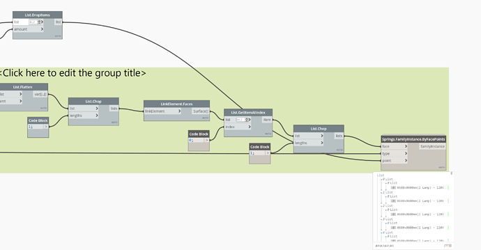

Thanks alot for your reply working with place by points doesnt work with face based families
Can you load the family you use?
MIM_HD.rfa (304 KB)
is this the family i have uploaded ??
which dynamo version you are used ?
could you share the python script of the custom node of Springs.FamilyInstance.ByFacePoints ??
could you see the link below
https://github.com/DynamoDS/Dynamo/issues/3821
I downloaded the code in the solution and the family that it sent. It worked as it should.
Version 2.02.
I’m Working with Dynamo v 1.3.2 … Is that make a difference ?
Version differences can sometimes cause such problems.
If you don’t have the chance to upgrade, you can install 2.02 on your special PC and fix the problem.
