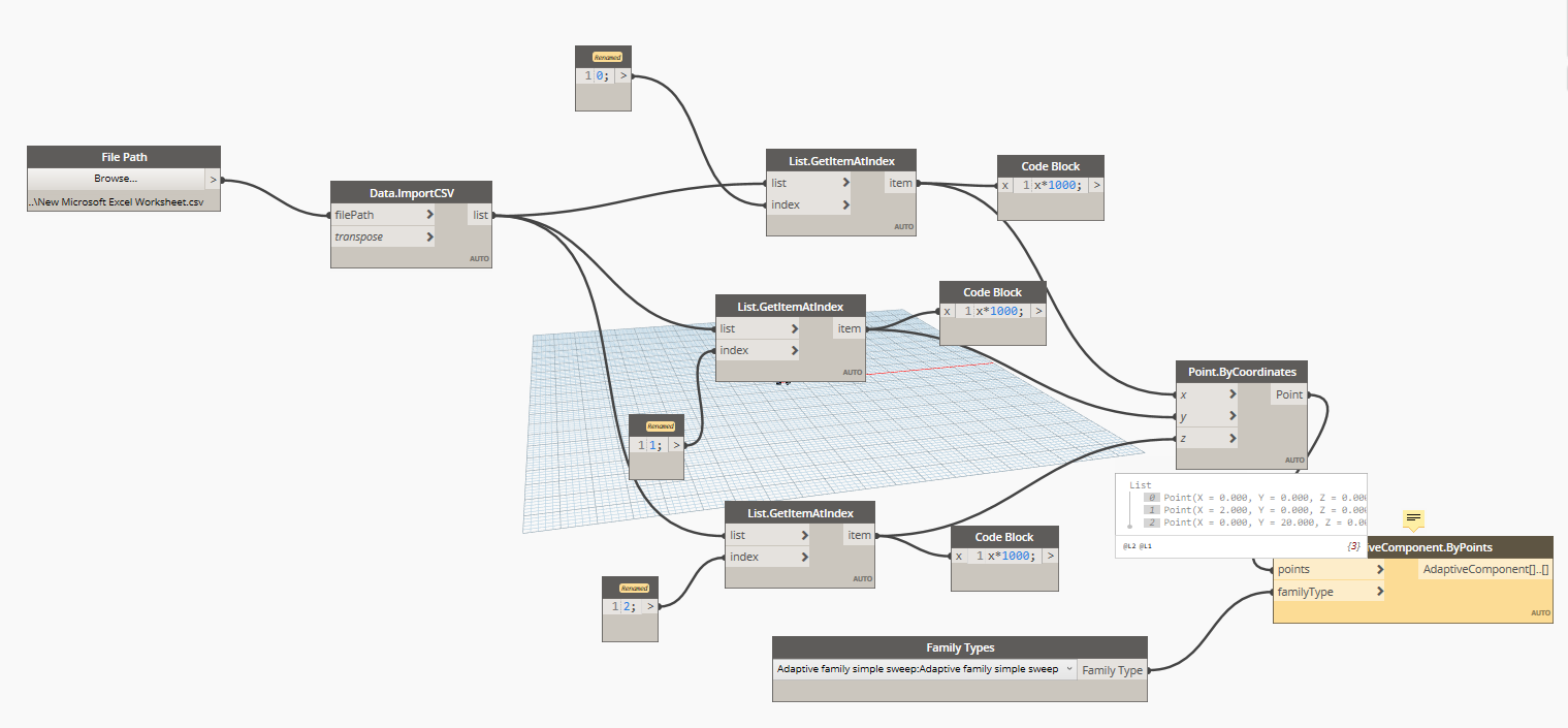

I would like to place 3 point adaptive family base on the CSV file which has 3 points as well. There is an error message in the script. It would be appreciated if anyone could help.

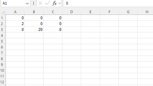

3 points from CSV
Adaptive family is attached
Adaptive family simple sweep.rfa (456 KB)
What does the error say?

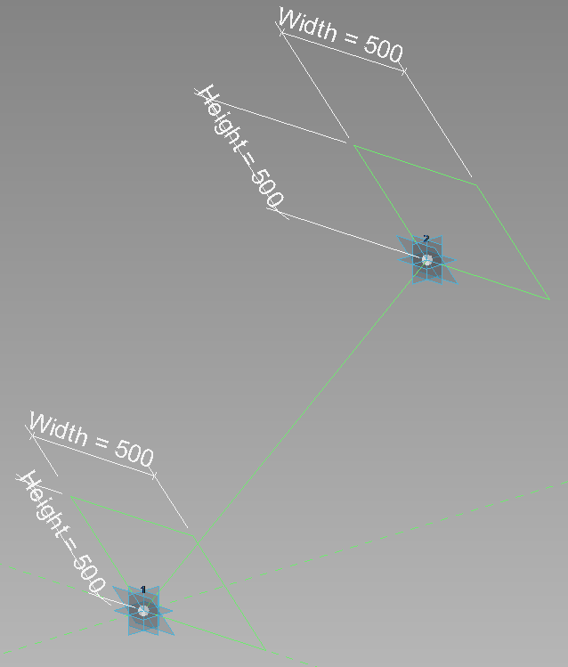

Your adaptive family has four points.

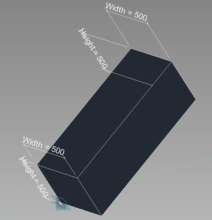

Another way to construct is to create a spline through two adaptive points - then draw the reference profiles on the end planes of the reference line. Constrain the profiles using type or instance parameters. Align edges to the point
Select the two reference profiles and create a solid form

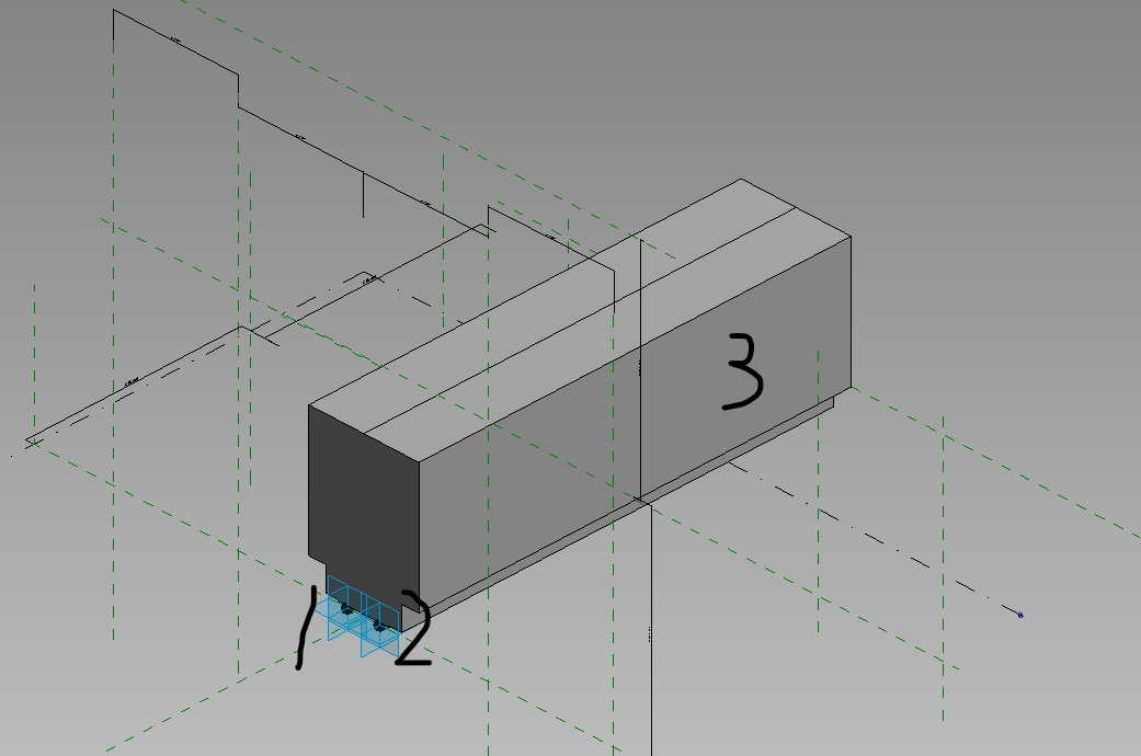

@Steven2026 Are you need to creat clearance profile for train (with adaptive family)?
