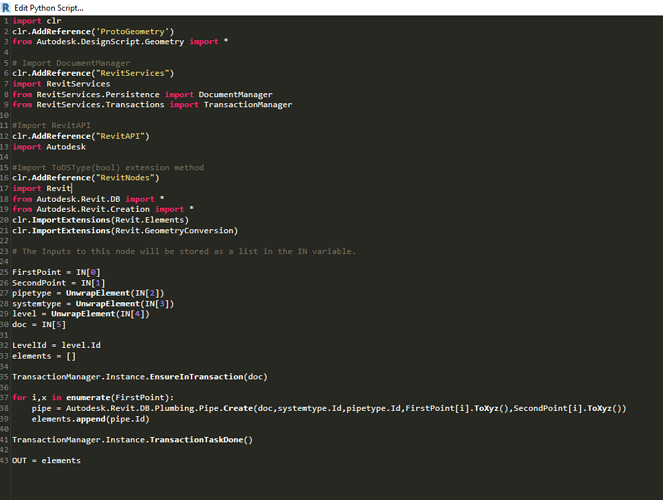

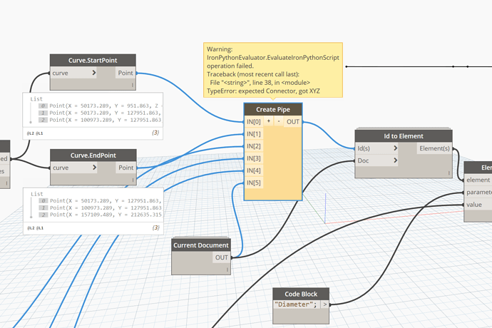

I followed the steps while everything was great until I bump onto the Python error.
I need help on line 38.
Please refer to the screenshots below.

You’re missing the Level Id on that line
Thanks Viktor!!!
it works!!!
BTW why is level is considered as a connector.
Sorry, just started with Dynamo.
It is not considered a connector. There are two other methods Create(Document, ElementId, ElementId, Connector, Connector) and Create(Document, ElementId, ElementId, Connector, XYZ) which use 5 parameters. Since you were feeding only five the API interpreted it like that.
