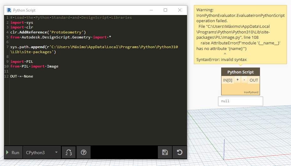

Thanks for your response and the links. But I still don’t know how to solve this issue.
I am getting this warning now.
If I import everything and I use ‘dir’, it seems that all is good.
But as soon as I use ‘Image’ from PIL, I got some warnings.
I think your PIL package (3.10) is not compatible with the current engine Cpython 3.8.x 64bits.
look at the links that I gave concerning the procedure to install packages
