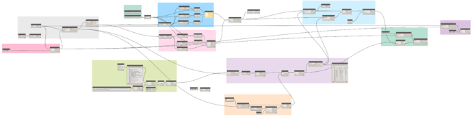

I am trying to create a dynamo script following this sequence:
1- uncrop the active view
2- select all the detail elements outside the cropbox and put them in a selection set.
3- crop the view again
the problem is I couldn’t apply that sequence in dynamo using Passthrough node.
@m.shaheenQVUGH what exactly is not working, from my side it did work, I notice you have an error in the first graph, which is related to Geometry Scaling, try to increase the value in the Preferences and it should work
I want to uncrop first then filtering the elements then crop the view again, I mean in that sequence not at the same time. but I don’t know how to make it properly
The passthrough node to re-crop the view is only waiting on the first uncrop to finish. You need to have it wait for the selection to finish most likely.
You will likely need to commit the transaction first. Try using a Transaction.End and a Transaction.Start node in conjunction with your pass through method.
Post your DYN (if not here on another source) with the pass through you added and I’ll try it later today. Building everything up is a bit time consuming.
