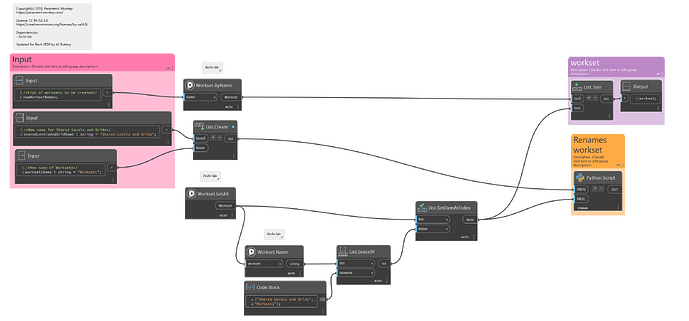

Going back some years now- there was a very handy ParametricMonkey node Workset.CreateAndRename.
I liked it because it would both rename OOTB worksets (Workset 1) as well as create new ones.
It doesn’t seem to work anymore (Revit 2026) and the Dynamo package manager shows 1.3.6 as being incompatible.
Is it possible to get this to work, or is there an alternative ??

@Andrew_Hannell you could download the package from the Package Manager, get the .dyf and replace the nodes in yellow. I don’t think these are available in the archi-lab package though.

Did a little refactor, cleaned up the python. :wink:
ParametricMonkey.Workset.CreateAndRename.dyf (26.6 KB)
