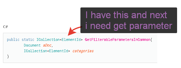

i have a ElementId of parameter
exactly get from this method:
http://www.revitapidocs.com/2016/7ea624c7-2c0d-c9bb-3b2c-1ac798cf6606.htm

Get all parameters exactly as Autodesk.Revit.DB.Parameter
When i use this method:
GetFilterableParametersInCommon
In my opinion , I get list with ElementId => and after convert to =>doc.GetElement(ElementId) => i get ParameterElement or SharedParametrElement => next I need get Autodesk.Revit.DB.Parameter (this my main question)
