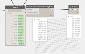

Peter,
what is the parameter that you are getting from the wall?
Z
Zach, i Trier it on type.
@ jostein exactly the other way round.
i have a given parameter and want to extract the content with a Code Block
@ dimitar: that is not the solution for my problem. i extract the wall parameter “Type”. the result is the ID of the Parameter like “26993” the value for this parameter = “WALLTYPE1”
what i want to do is to manipulate the “WALLTYPE1” and write it to a 2nd parameter. This i tried with a code block to get a result like:
“WALLTYPE1” + “TEST” = “WALLTYPE1TEST”
what i got =
26993 + “TEST” = “26933TEST”
clear???

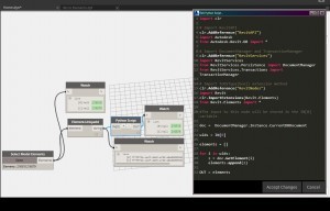

---- I solved the problem with standard nodes and python code. i am trying to find out a Code Block based solution.

S T O P thinking!!!
my mistake… connected a set parameter node instead of a get parameter node…
sorry for the inconvenience!
everything working with code block like expected.

Also: Grimshaw has a package called Id to Element, in which you get elements from a list of id’s (ElementId, string, integer or GUID)
