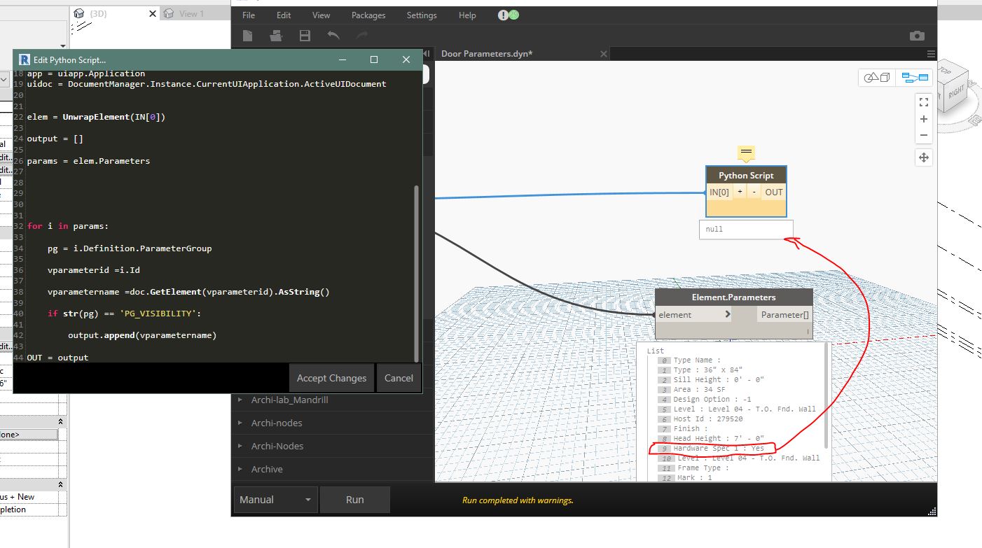

I want to get all the parameters of a specific element category and append only the parameters from the visibility parameter Group., I can do it in Dynamo using Nodes, But i need to iterate thru a lot of instances so i tried to do it in Python.
I tried a similar post but didn’t get any results:
I only need to get the element id of all the parameters of the element, then i can check which group it belongs to and filter the results silimar to the pseudocode attached.

Almost there…
Parameters%201
I managed to filter the parameter by parameter group…but i need the output to be a "string" of the parameter name…Eg…hardware Spec 1" in this case.
