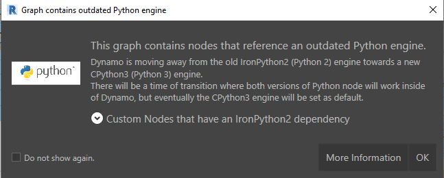

Hi, I’m worried what will happen when this happens? Ideally I just want all my old scripts to just continue to work with updated versions of dynamo that come out with the same packages. Will I have to go through every computer and change a setting back when it becomes default so it works?
You’ll need to ensure users install the IronPython package from Revit 2023 onwards unfortunately. It’s to do with IronPython having security exploits I think, they’re moving away from it given it’s older now.

Now that we have some background on why the change is happening and the history on the topic, it’s important to note that there are options.
  1. Change all the Python Everywhere that uses the IronPython engine over to the CPython engine. Sometimes this will be easy (one or two clicks), sometimes not so much. I believe the ‘switch’ can be flipped between engines in bulk by editing the .dyn and .dyf via automation routine; however the resulting custom nodes and dynamo graphs would need to be tested very carefully afterwards. I was going to release some code showing how this was done as part of my AU session… I’ll try and find another path for it now though as I didn’t make the cut with that one.
  2. Download the IronPython engine form the Dynamo Package Manager. Users will see this message when they open a graph, but they can be taught to “hit ok” and continue on their way. This does come with the previously mentioned security risk of keeping a Python 2.7 environment available in your network, so review with your info sec teams.
  3. Ignore the problem and hope it goes away. This is a bad choice, but I hate only giving two options so here we are.

Thanks for your options. It looks like 2 would be best suited for me. Does the IronPython engine download from the package manage install to the usual package location? I can then add it to the master package folder on my server and send out an email with a link that people click to robocopy to their folders.
Also all users at my firm use dynamo through dynamo player. Will they get the “hit ok” message through that?
