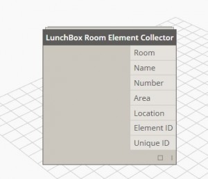

Node “LunchBox Room Element Collector”
does not work for Italian … … I have to change python script ??
help
help

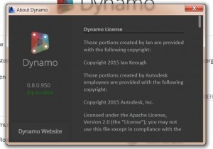

Alex, what is your Dynamo Version?maybe download New lunchbox
thanks Peter

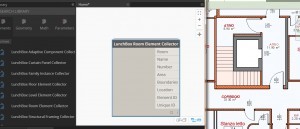

I installed dynamo and lunch latest version but will not start
maybe you have to change with Italian python?
alex italian should not be the problem ( i am running german).
but there is an issue when updating to 8.xxx.
maybe you remove 0.75 or whatever you have installed.
thanks Peter
I installed lunchbox 2015 with error message (attach)
Use dynamo 0.8.0.950
dynamo 7 removed

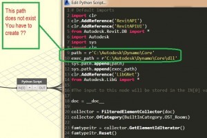

Picture Script python lunchbox
This path does not exist
Y
ou have to create ??

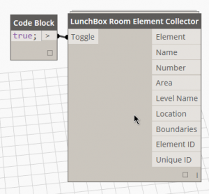

That definitely isn’t the latest node. The latest node has a “Toggle” input. Also those paths you pointed out are only needed for Dynamo 0.63 and older.
Could you try closing Revit and Dynamo and then go into Dynamo’s packages folder. Paste the below path into your explorer:
%appdata%\Dynamo.8\packages\
Once there, manually delete the “Lunchbox for Dynamo” folder?
After that try downloading the latest version once again.
