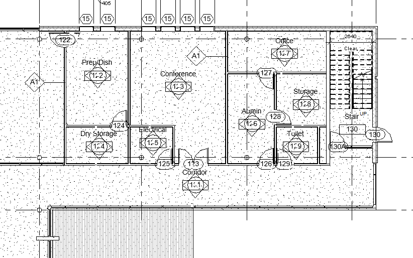

I am trying to generate elevations for more than one marker. the node doesnt process lists and lacing or levels doesnt seem to help??
i hacked it together with some list cycles and chops…
no need to cycle if you use the @level feature of Dynamo.
which results in:
dunno why its not working in mine. Revit 2021 Dyanmo 2.6 current packages…
ah well - the Rhythm node works. the Dynamo>Revit one doesnt. I wanted to use the base one because Rhythm hasnt been updated in a while and i want this node to survive a bit.
