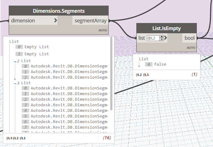

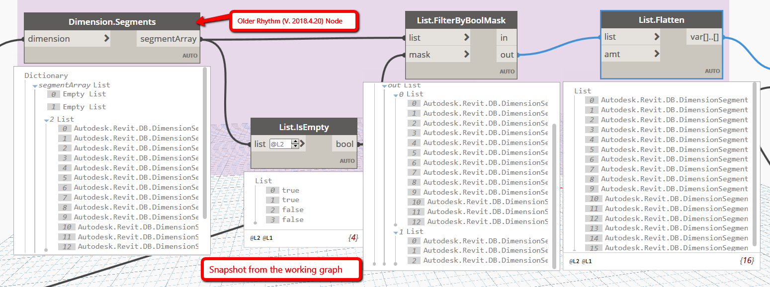

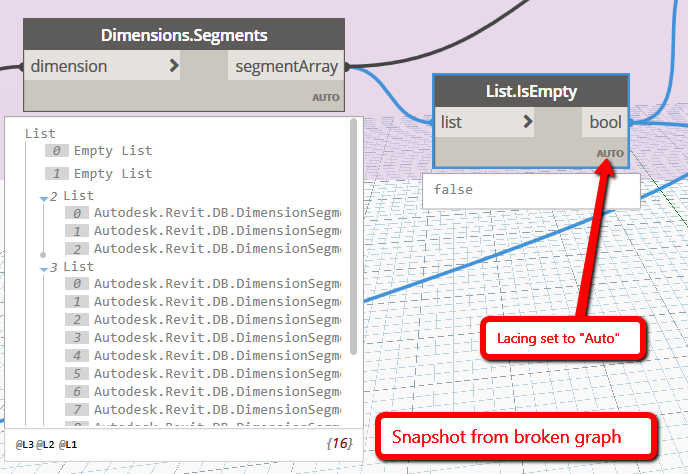

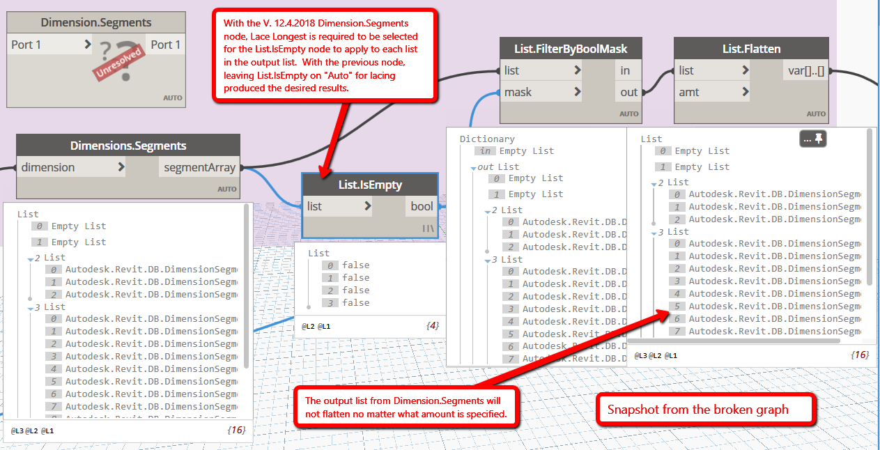

What seems to be happening is that no other nodes will interact with the output list of the Dimension.Segments node. The screenshot below show the old node and results from a portion of my graph. The other one shows the same area with the updated node. Four dimensions were selected, two were multisegment, two were single segment.
As you can in the second shot, The List.IsEmpty node needs lacing to be set to Lace Longest to apply it to every list coming out of the Dimensions.Segments node. Further down the line, List.Flatten doesn’t flatten the list. The List.FilterByBoolMask node further on down the graph (one not shown in the screenshot) doesn’t do anything to the list either (I know it appears to work in the screenshot below, but I’m not sure it actually is given the one down the line).
