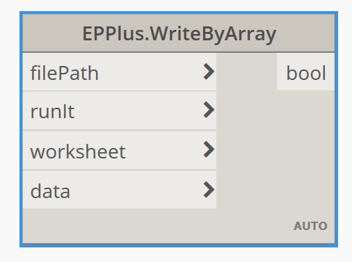

Hi I would do as Gavin mentation but if dont want that then try this one here from archilab…it had worked for me, before we fix with the repair
Screenshot 2022-05-24 184144
