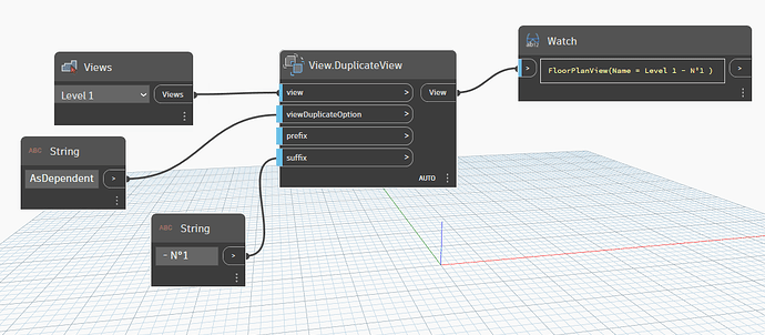

I’m trying tu use the node View.DupplicateView but it doesn’t work as expected.
It works only 1 time. I create 1 view as dependent but when i launch the script a second time with an other parent view, the first view created is deleted.
Do you have the same issue with this native node?
I’m using archi-lab node and it works but i want to use this one
Thanks for your help !
Sounds like element binding. Read through the link and see if you can clear out the bindings. If your graph is only the handful of nodes that you’ve shared, it may be faster to just create a new file and see if that fixes the issue.
