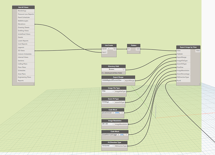

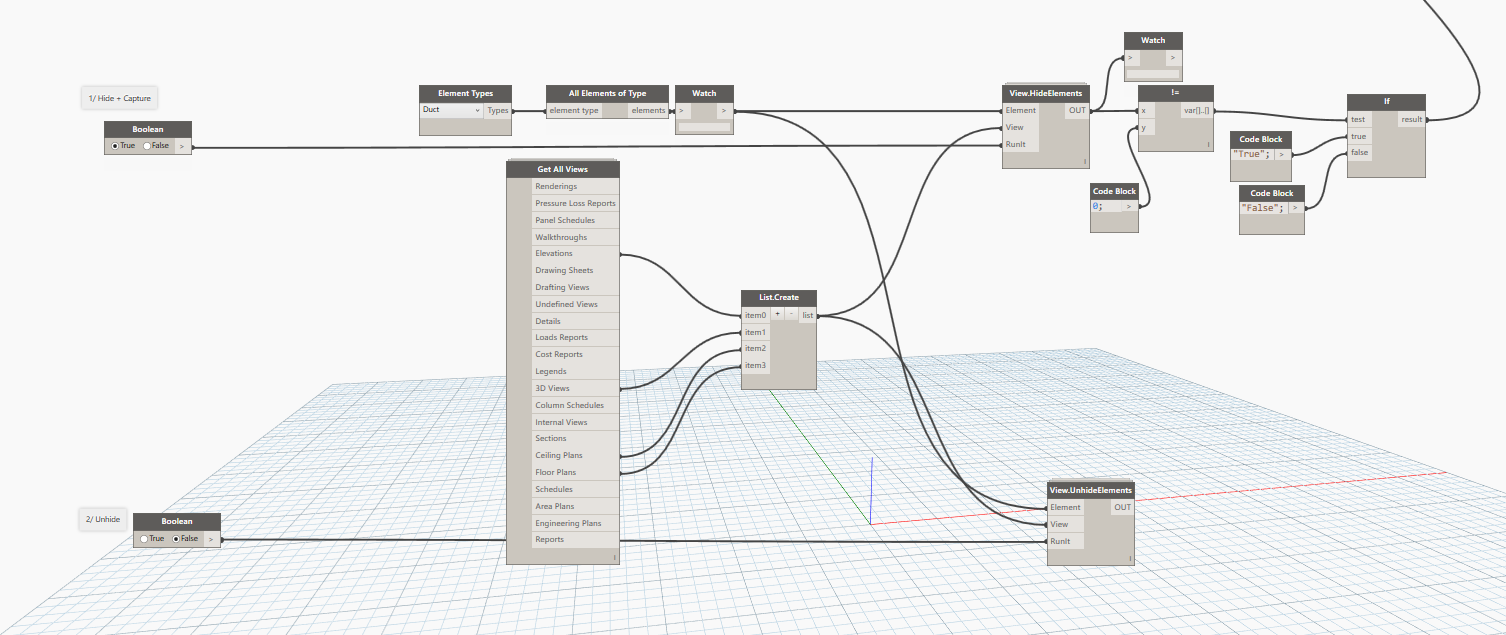

I would like to hide the duct first and take the captures after that. Lastly, I would like to unhide all the ducts.
- I have tried using the if node, but the dynamo still went through all the processes at the same time.
- Are there any ways to connect these 3 steps, in order to run all the function automatically?
