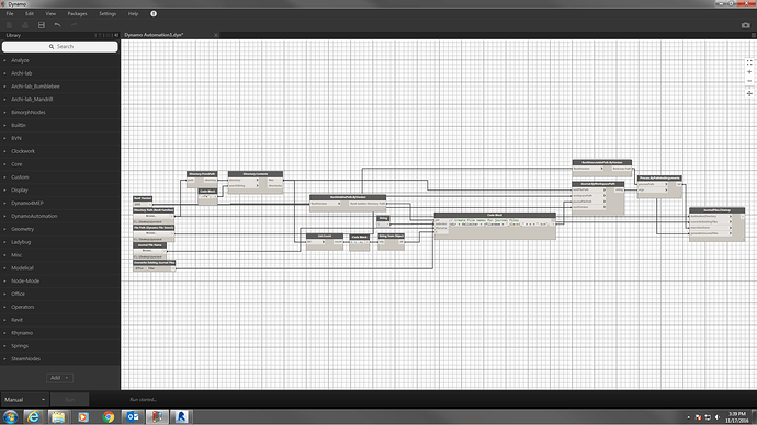

@Andreas_Dieckmann What am I missing? The script opens Revit, but then it just sits there. I had to modify your example to fit my needs. Basically, the script runs one slave script rather than 2 and it doesn’t place the family in a project.
BTW, your youtube video is crystal clear now. Now sure why it was so blurry before
