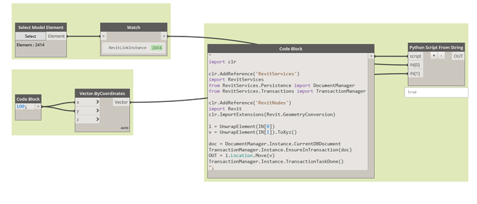

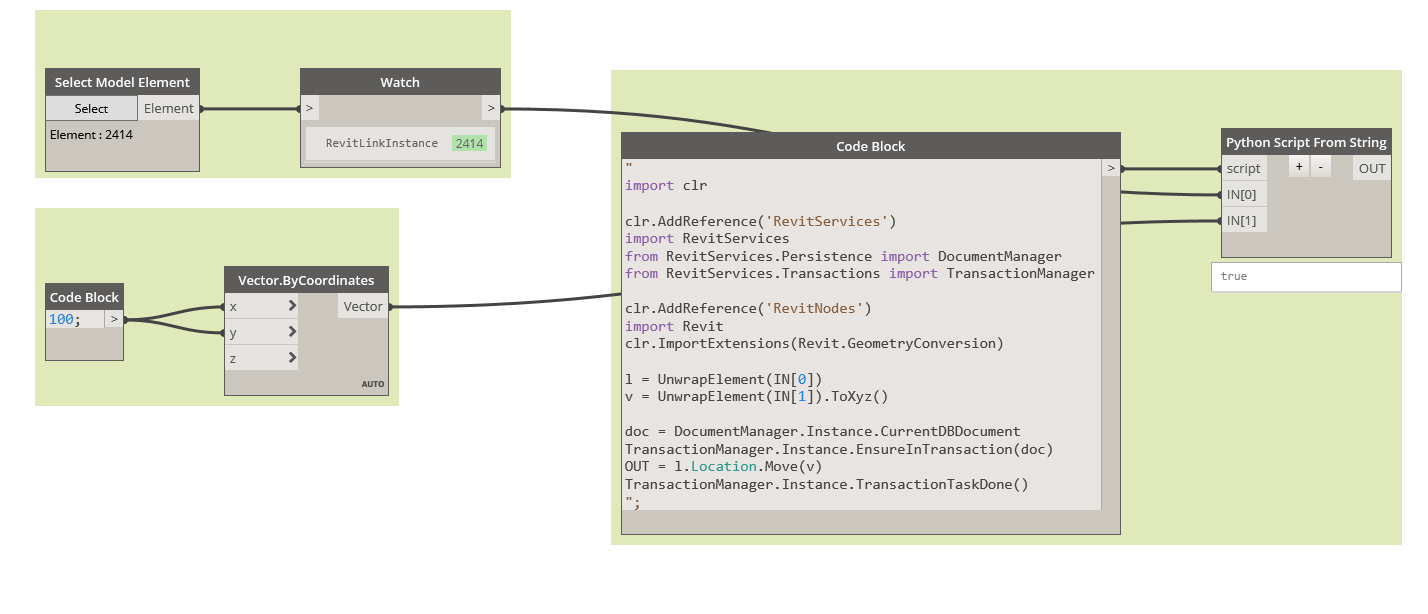

Great! Thanks @Tomasz for nice script :ok_hand:t2: Will be possible to make a move for all the linked files? This script is working perfectly with one selected element. Will be possible to make an action choosing RVT Links category?
The second image shows how to select all link instances. If you need help with sorting logic - post your graph.

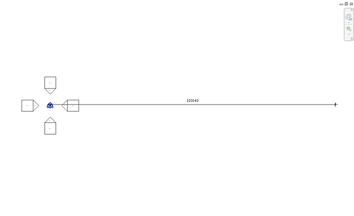

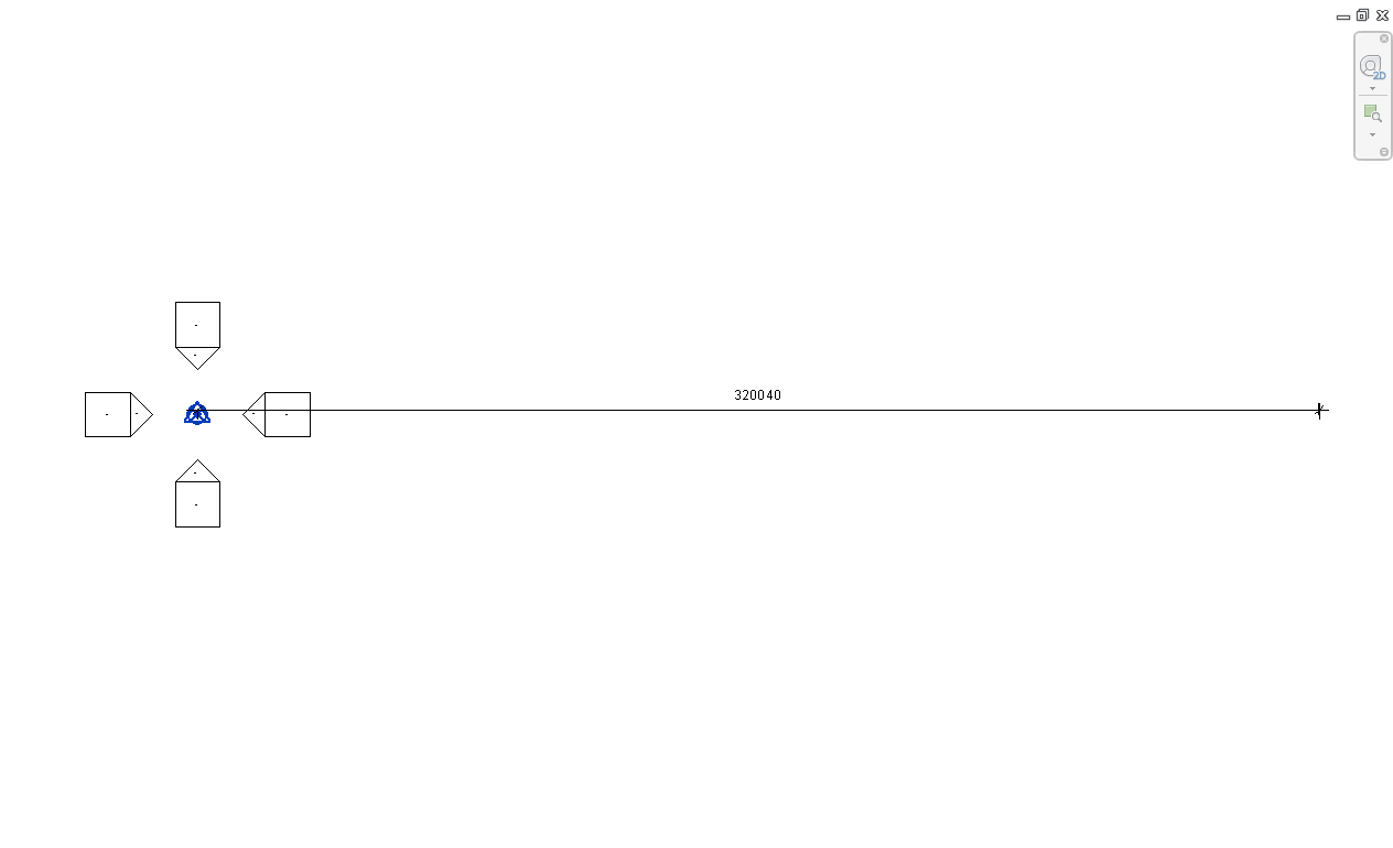

Hi, Tomasz. I used your script to move a revit link and the result is that the linked file had been move with a wrong distance. For example, a vector X=1000,Y=0,Z=0 in dynamo while the vector in revit is X=320040 ,Y=0,Z=0. Do you know what was wrong?
what is more ,Will be possible to rotation the linked file at the same time ?
thank you very much.
Yes, it is possible to rotate the link using Location.Rotate method.
You also need to convert units. Revit API uses feet and Dynamo is unit less. Here is an example of one approach to convert between units.
