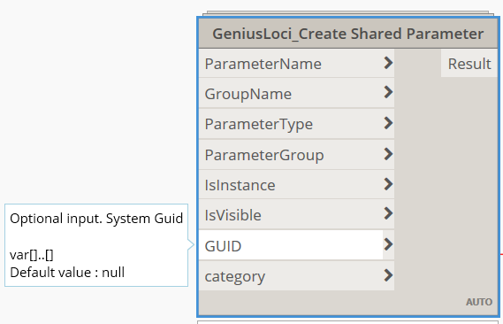

Be careful in your manipulations but I will personally use the Create Shared Parameter node and his optional input GUID.
It allows identical shared parameters to be recreated in the current shared parameters file from a family or another shared parameter file.
Recreate SP

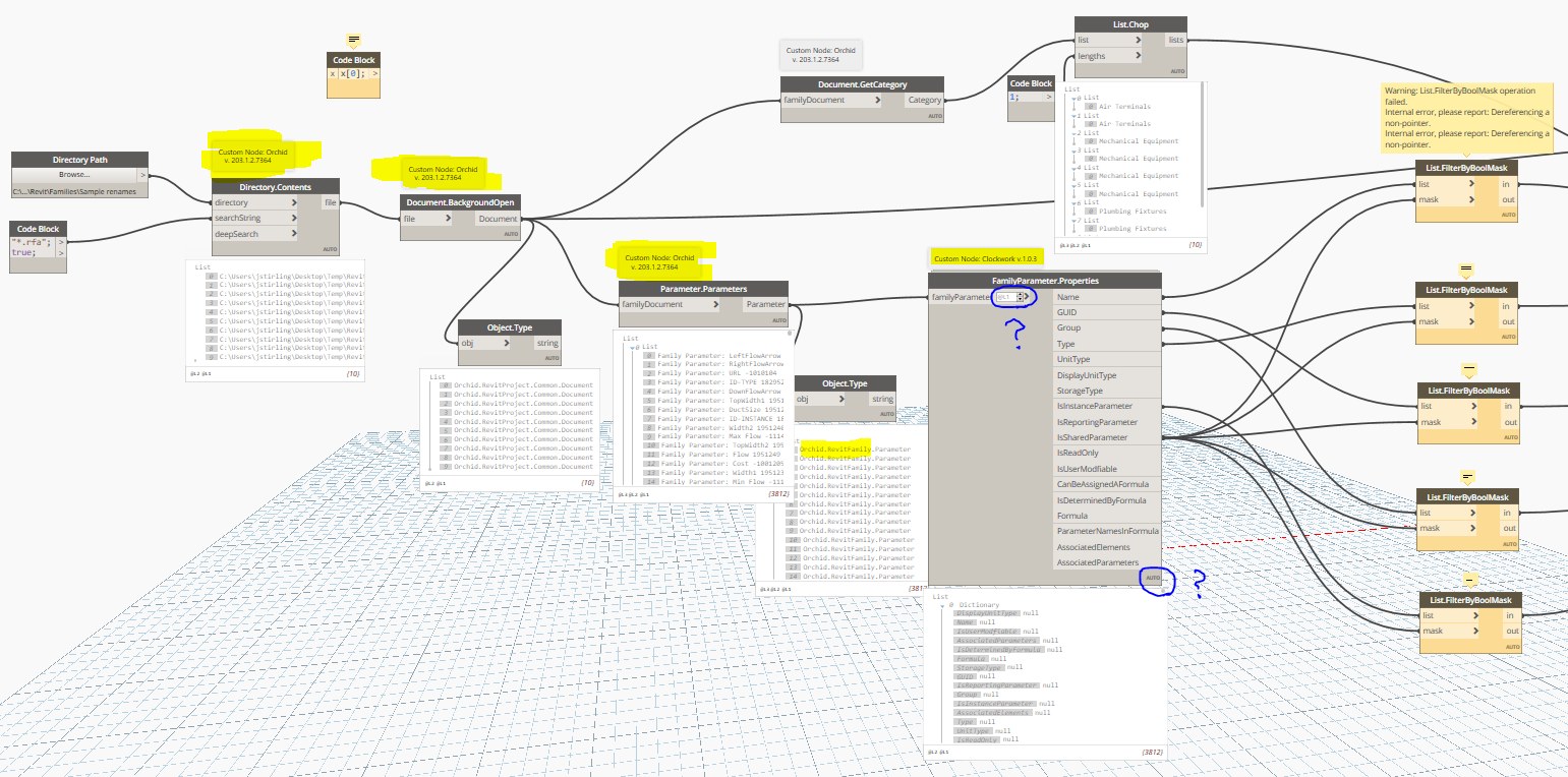

Haven’t done any testing yet, but one more question before I do later. Let me clarify my intention of this task.
I’m developing a startup MEP template. I’ve been given families with shared parameters I would like to keep intact, however I’d like to add a prefix to them.
Provided these families (and really the entire template) have not been used on any prior projects, could I rename the parameter at this location of the graph you provided earlier in this post?
If yes, how would this impact scheduling? Would I have to basically remap the scheduled parameters to the renamed ones, or not since it’s essentially the same GUID.
In my mind I think I’m getting my point across right, but maybe I’m just way off on the entire topic.
Thanks!
No success thus far. I’m pretty limited with my knowledge on most of this stuff, but I feel like the Orchid nodes are not communicating well with the Clockwork nodes. Could there be any truth to that? Are there other packages or nodes I should be using instead?
Also, any input on the levels and lacing for the Clockwork node.
Some of the Orchid nodes are no longer compatible with the other nodes.
Use other nodes instead.
