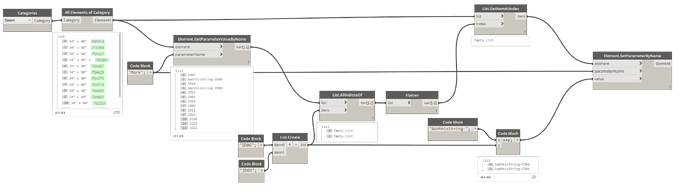

Hey,
Is this something like what you’re after?
Capture Mark Value Change _ 14-01-2019-MKA.dyn (29.9 KB)
I can’t easily test it without a rvt…
Hope that helps,
Mark
Edit: slightly updated
That I understand :wink:
But now we still have to run things to understand what goes wrong. A screenshot with the errors is usefull. Not everybody uses Structural Framings with the Mark name “TF-HCS250-010”.
So without being able to test things properly: the unlogical part is in the middle. list allindecesof. Furthermore don’t use the getparatervaluebyname as element input for setname you need the actual elements.

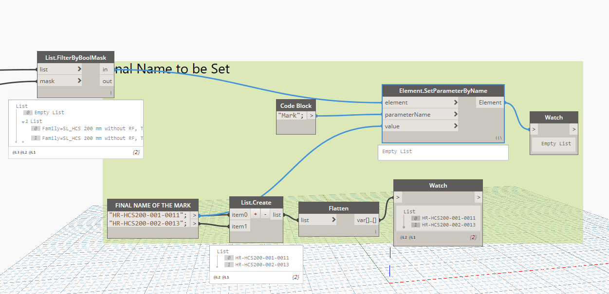

I want to change multiple mark values ! Getting Error !
you can’t check a list with single values.
In your case: the two mark names “HR …” is a list. Use the node List.contains.
But, what are you trying to achieve? you have a bunch of elements which you filter by mark value. and afterwards you set those specific elements to the same mark value?

I am trying to Filter Bunch of Elements using Existing Mark Value and I would Like to Replace existing Mark Values by new mark Values.
So this is the problem…
The == isn’t working for you.
Try this…
== is working fine and filtering after giving multiple inputs;
Last Node isnt replacing Multiple New Values to Old Values.
I have multiple Values at Element.SetParameterByName !
How shall I give multiple Value Inputs at this node; kindly guide !
== is working fine.
I have to finally change multiple mark values by new values ;
Each Mark Value is unique
You are feeding an empty list, so it has nothing to update.
Because your == is not giving you the output you want.
Yeah, you are right. let me try your suggestions for ==
