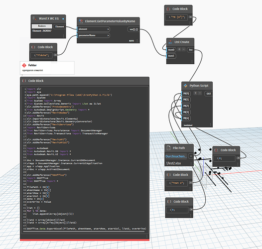

I did but it is expecting a openpare? What does it mean?
You need to pay attention:

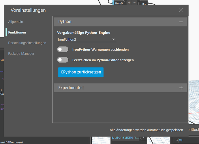

Your python node is set up with cpython3. You need to change it to ironpython.
Its still giving me the error quote… :confused: i changed the settings to ironpython and the python script node. While doing Dynamo told me, that ironpython is an old version and is no more supported.
Wait, do you mean this one?
You cannot use python language in a code block. Furthermore your python node does not throw an error.
The original code was written for Revit 2019 and I just tried it in Revit 2022 and it still works if the python node is set to ironpython:

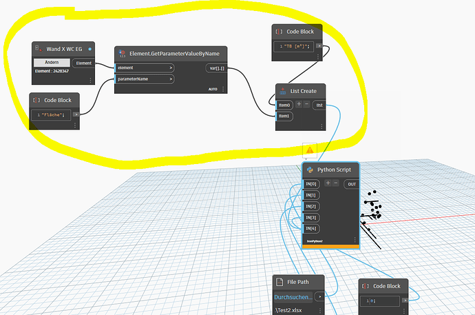

Still im trying to do what youre doing but it doesnt seem to work. The wall gets moved so the rest of my script seems to work through.
But the Excel file wont pop out. As you see on the picture i tried changing it from Python3 to IronPython and even used the migration assistant, but non of this helped.

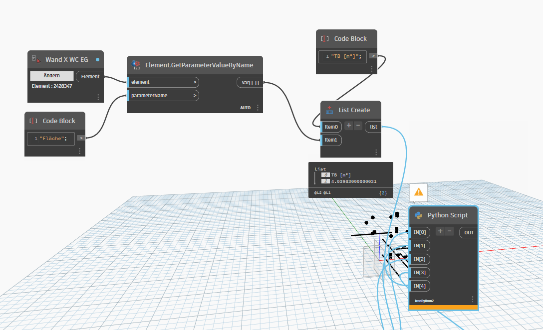

Can you turn on the preview for your list.create node? Seems to be an issue with that.

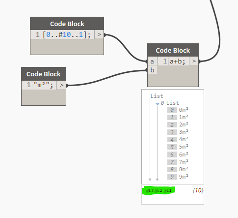

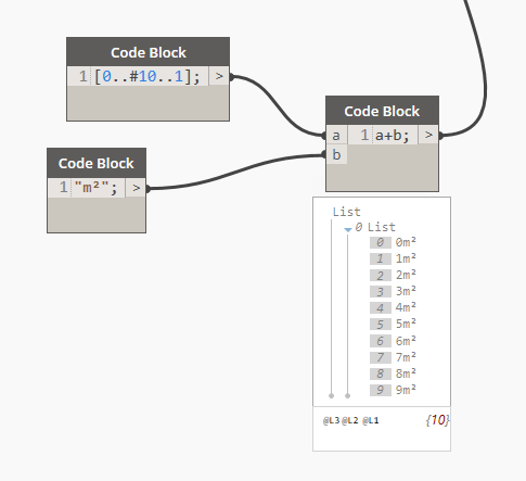

I can just guess at the moment, but are you trying to concat the “TB m²” to values? Then you could do it like this:
Sure. Here it is. Like i said. Im trying to get a Excel where multiple elements are getting listed with their value for every loop (moving them step by step)
You forgot to turn on the preview, like I did.
Sorry my bad.
Found the error. You need a data input list with three levels:
Replace your List.Create node with a code block like this:

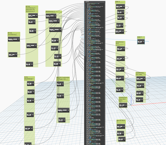

Hey,
so i used the node to code function to translate my nodes and connections to a python script and got this huge code. For some reason it does not translate the selected elements into python code.
My question is:
How can i use the code so the integer sliders will loop through the first, second, third… so every possible statement will loop through. Then i want to connect it with the excel python script so every possibility is put into excel?
