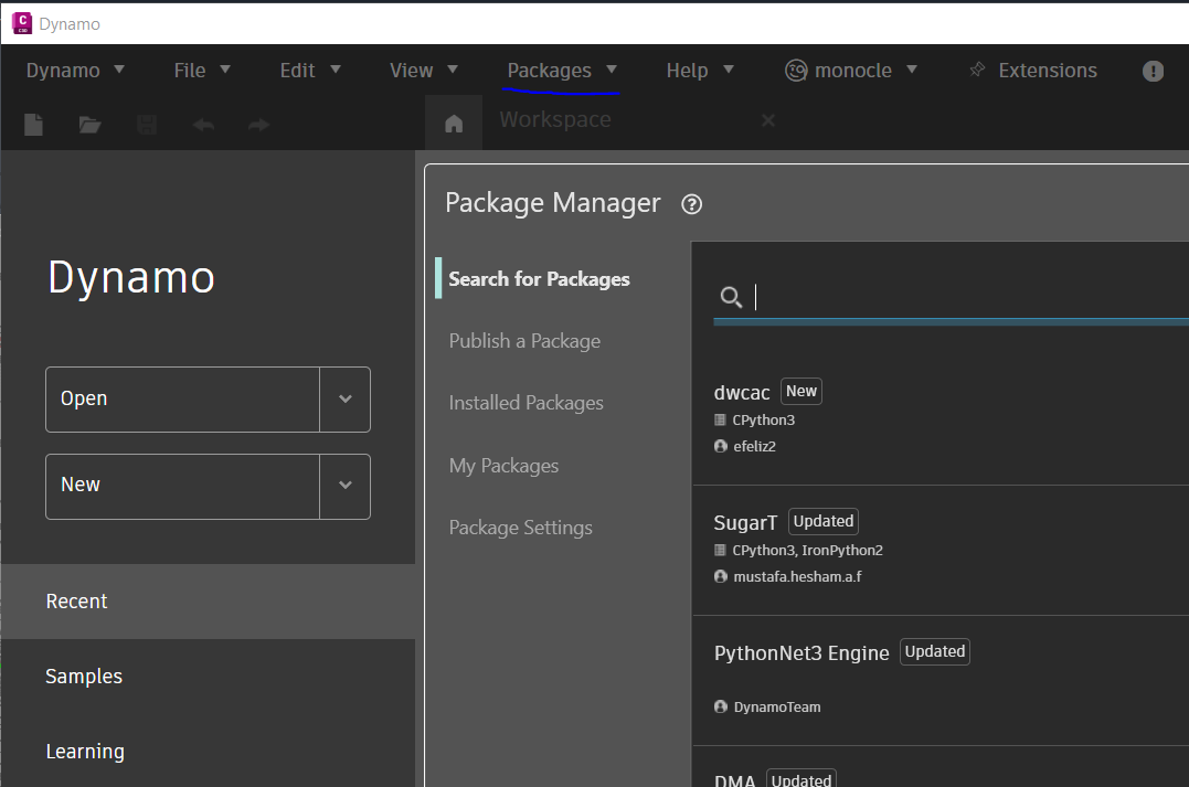

You can find it in the Package Manager where you can install them. No need to find a website for the packages :slight_smile:

Just open Dynamo in your Civil3D environment and look for Package Manager as @Anton_Huizinga referred. Then you can search for packages.
