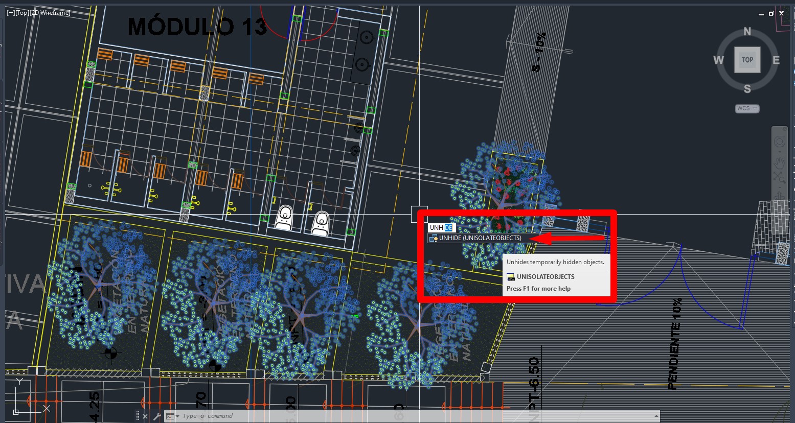

ISOLATE and UNISOLATE objects in CIVIL 3D...?
Good morning.
Could someone tell me where I could find a node that allows calling this command in civil 3d?
