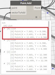

I have two lists of points
I have to take the points as shown:
- For example, points [0] list of the first list (in red) I associate them with points [1] list of the second list (in blue)
or [0] list [0] point with —> [1] list [0] point
I could not do it
can you help?
thanks

Your end result is a bit unclear. Maybe you could provide a quick sketch? This is what i understood:

I take the values of the first list (in red) and associate them with those of the second list (in blue)
You should have a final list:
Point (x = 7655 y = 0.30) from the first list
Point (x = 7655 y = 5.70) from the second list
and then
Point (x = 3.499 y = 0.30) from the first list
Point (x = 3.499 y = 5.70) from the second list
and then
Point (12,499 x = y = 0.30) from the first list
Point (x = 12 499 y = 5.70) from the second list
and then
Point (x = 3.499 y = 6.30) from the first list
Point (x = 3.499 y = 11.70) from the second list
etc.
For these points then insert the wooden beams.
Thanks for collaboration
