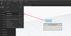

… and I still can’t find anywhere how I add comments to my dyn files.

Here is how you can add comments to your dyn file.
