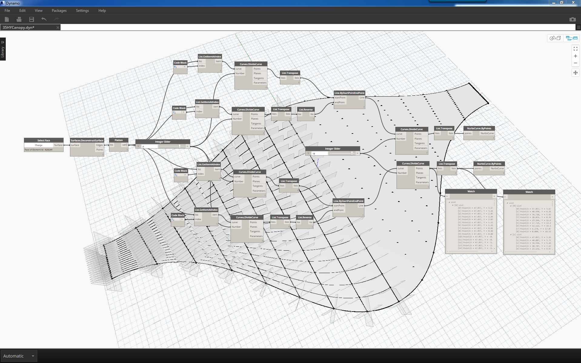

I’m getting myself into a little list management hell.
Trying to organize these points so I can get a 4pt adaptive component to work. It has me a little stumped.
Thanks for your help.
Try an alternate approach…
  • Divide the surface into multiple four cornered sub surfaces
  • Extract Point geometry from the corner vertices (use Topology.Vertices)
-You should obtain points in groups of 4 (for each sub-surface)
  • These points should help populate your adaptive component.
Thanks Vikram.
I was able to use Lunchbox in grasshopper to rebuild the surfaces.
That organized the points for me.
