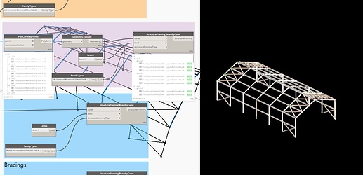

Hi everyone,
I am following the tutorial here and i want to take it further by creating the model in revit. However I’m stuck when converting the list of points to curves. Please assist me
Portal Frame.dyn (39.4 KB)
Hi everyone,
What does the error on the first yellow node say? It’s helpful to expand these so we can see what might be causing the problem.
Not sure why you are getting an error on PolyCurve.ByPoints (please post the error as suggested) but, StructuralFraming.BeamByCurve wants to be fed with lines, so you would need to explode your PolyCurve.
