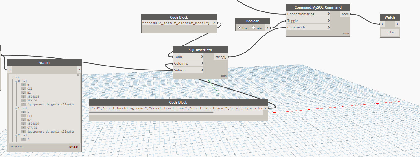

I wrote a dynamo script for exporting Revit data to a MySQL Database. The script retrieved only 1573 line, however the MySQL database is populated with only 183 line. Besides, the database is populated even if the the SQL command node output if false.
Have anyone encountered this king of problem ? Is it related to the model size ?

Do I have a timestamp that tells you the 183 rows are from this run? From the looks of it it shouldn’t be writing anything since it’s set to false. The Command node will show all 1582 because it works independent of the actual write node.

Take a look at the 184 line of data and see if there is some different like a comma or other punctuation that may break the output. A lot of DB configurations won’t allow injection prone characters unless they are escaped.

A trouble-shooting step would be to take the SQL node output from Dynamo (export to clipboard or a text file) and run that in Workbench- this will give you a meaningful error
