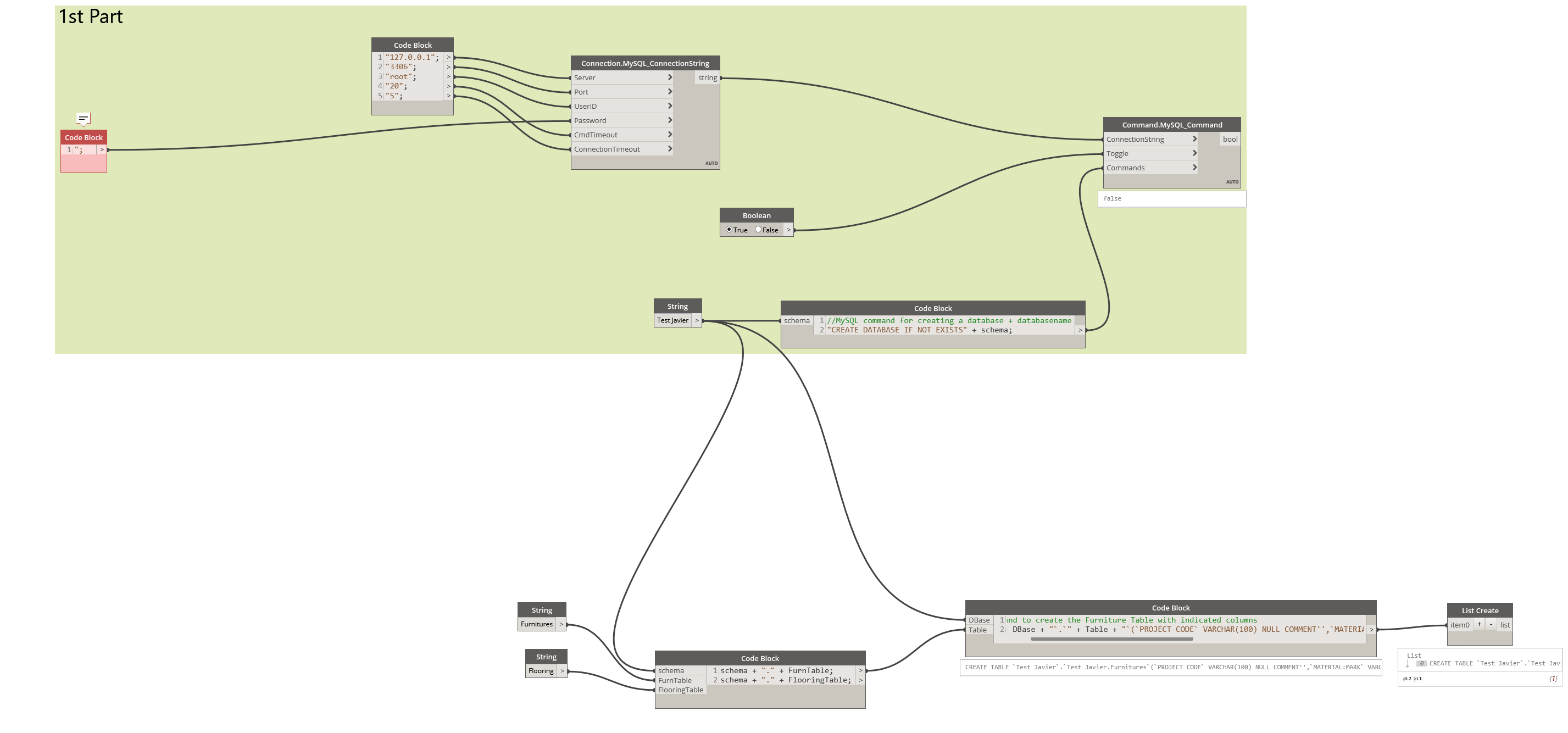

I am trying to export my Revit Schedules into a database (MySQL Workbench) and to be honest I am a bit lost as I am not very skillful in Dynamo and MySQL but, it is something that has been required in my company.
Doing some research I’ve got to the point that Slingshot package would be helpful for this but I am running into some problems.
The first one is that when I am trying to create a new Database with the node “Command.MySQL_Command” the outcome is just “FALSE” and I don’t know if the “Test Javier” Database should be created just with that or more steps are needed. (See image attach)

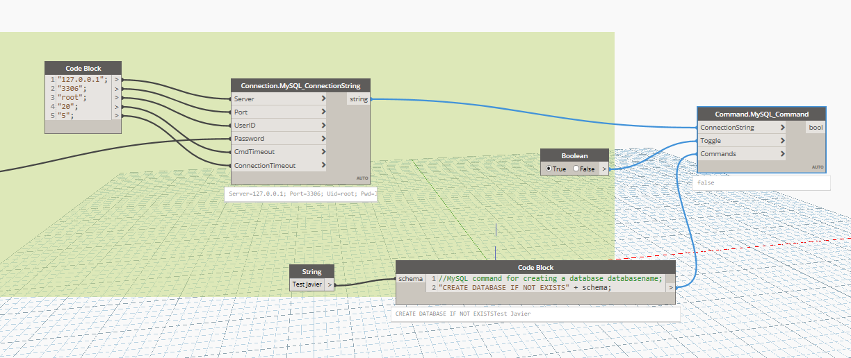

First issues that grabs my eye is your password code block is red meaning syntax error. “1” would be a string for 1. its erroring as you have 1".
As the Connection String Node output is not shown I am guessing that the connection string node is not creating a usable string for the command node to work.

The password is in red because I didn’t want to show it. Sorry for that.
Even when I insert the right one the command work doesn’t work.
Maybe the code block before the command isn’t right?I am not sure…
Many thanks,
Totally understand the password bit. Next guess would be syntax of the SQL command. It looks like the Command Code block is outputting the scheme and Exists as one word. Maybe try, "CREATE DATABASE IF NOT EXISTS" + " " + scheme for it to output “CREATE DATABASE IF NOT EXISTS test Javier” instead of “CREATE DATABASE IF NOT EXISTStest Javier”.

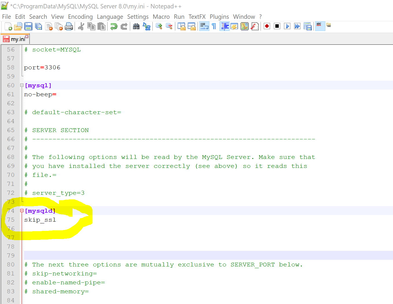

the problem is most likely MySQL security settings
Assuming you ticked the option to open relevant firewall ports when you installed- you may need to disable SSL. I believe this defaults to on in later versions. This is why MySQL is not the easiest for beginners
As before: start off simple- such as a SELECT query (rather than trying to create a schema)
Hi Andrew,

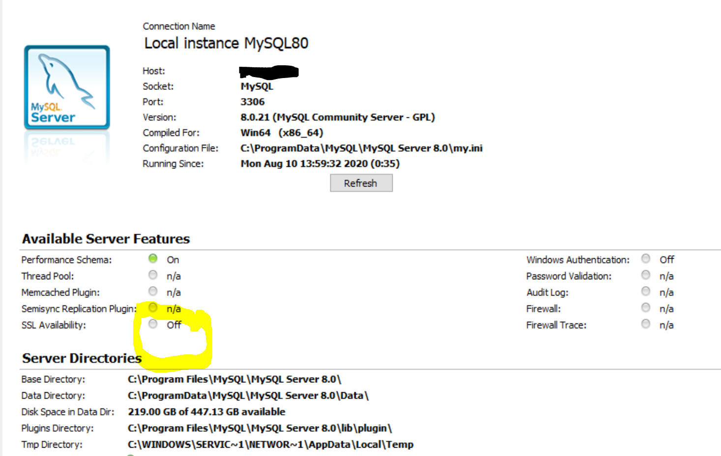

After adding “skip_ssl” into the “my.ini” , Did you just save and when opening MySQL Workbench again the SLL Availability should have changed to Off right?
I did that and it did not work for me…
you’ll need to restart the MySQL service (or the PC)
When you restart workbench, you’ll probably need to edit the connection settings
