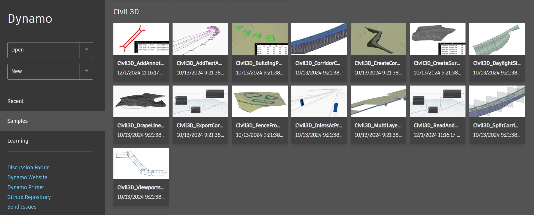

Dynamo is worth learning. I am also civil engineer at road design and I don’t even want to remember days then there wasn’t Dynamo. Good news is that Dynamo has many great examples within its resources. Have a look at this section, plenty of cases which you can benefit and build your own custom graphs:)

i had no idea about this samples
thank you very much !
