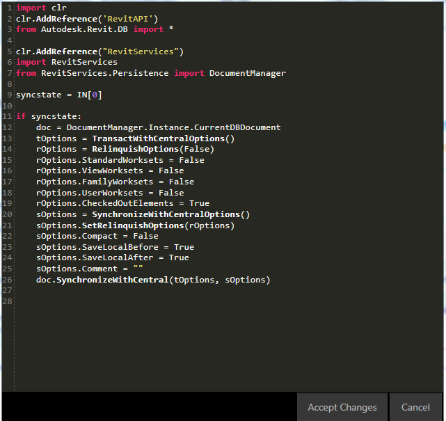

Old LISP coder guy here, way out of my element. So I started working with Dynamo and my goal is to create a timer. I’m measuring network latency and want to time the synchronization process. I think I have the timer part done but I can’t find a way to initialize the synchronization of the models. Can anyone point me in the right direction? Thx!

Hi, I was wondering if someone was able to get this synchronize node to run?
@Ben_Barfoot does this code throw an error? what happens when you try and execute it?
This works fine.
I just added doc = DocumentManager.Instance.CurrentDBDocument
Save yourself some typing here; http://pastebin.com/qysL7s3V
