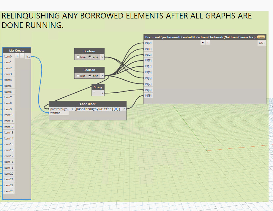

I’m using Document.SynchronizeToCentral node for my script along with 20 other graphs.
My idea is - ‘run all the 20 graphs first and relinquish before closing’.
This is what I did
My question is does Document.SynchronizeToCentral node automatically runs at the end? I have 20 different graphs in one dynamo file, what would be the sequence? lastly, do I need to use passthrough if I want to achieve what I’m looking for? I dont want the node to relinquish/sync before all 20 graphs have been finished.
Thanks much guys and let me know if you have more question!
No, it will run when it receives all inputs.
Graphs are Dynamo files, so I’ll assume you have 20 disconnected branches. Joint them together and use a wait method to hand off the valid input to the clockwork node.
Yes.
