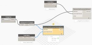

This is what I came up with.
However I’m currently stuck on setting the Phase Filter to None. Any idea on how to achive this would be very much appreciated!
That one seems a little bit ore difficult. Whenever I even try to get the value of a view that has none, it errors out.
Ok, thats just a small issue anyway. The problem of the Topic is solved!
