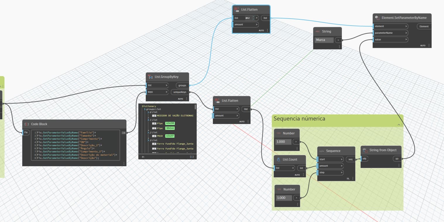

So, I made this routine to filter connections and pipes, and it counts the connections filtering by type, length, diameter, etc. After counting, it separates and assigns an equal value to the same connections. However, I’m working on a project with phases, and I would have to create a numbering for what will be demolished and another numbering for what will be new.
I just can’t make it work, to put it on everything worked out, but this filter of only numbering what is in the “demolished” phase I can’t manage. I’ve reached my limit!!

Phase Created is just a parameter, so you would get that parameter value from each element as well. That should return an phase element which you can get the name from and then you can group the elements by phase name or the combined values, whatever you’re after.
I don’t know how or where to insert this filter in this code, I’m stuck, I don’t know where to go.
You already get the other parameters. You need to do the same thing with Phase Created. I don’t know the logic of how you want the elements filtered, but I assume it would either be the same as you’re doing now (just add in the phase name) or the phases would be filtered separately (use the same logic before/after the combined values).
