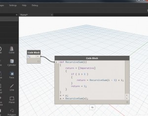

Iâve attached a simple example of a recursive function that simply computes the sum of the input=5 where 1+2+3+4+5 =15
Notice the presence of an [Imperative] keyword which allows you to do this. The syntax is a bit quirky and we are thinking of ways of introducing this. However, the DesignScript engine has supported this from the get go.
