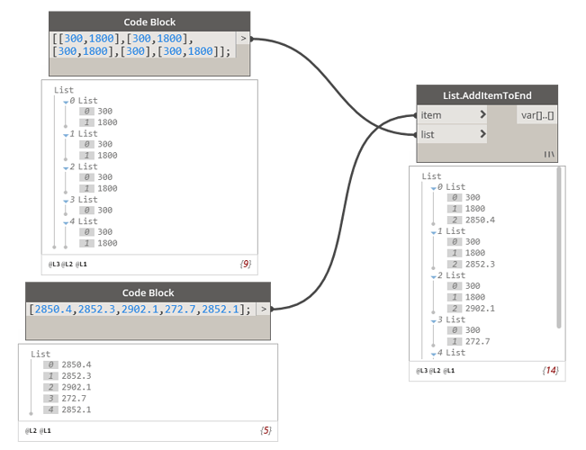

I want to merge this 2 List like this.
ANy Help?

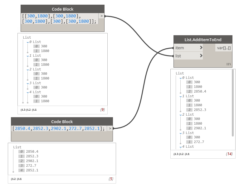

Use List.AddItemToEnd node with lacing longest.
List.combine with a list.join as combinator would also work!
With that method you could also change some thing a little bit if you need to and you can extend it to have 3 lists as input.
https://dictionary.dynamobim.com/#/Core/List/Action/List.Combine
