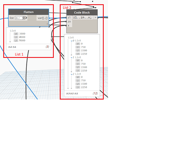

How can I add the items in List 1 to list 2. I want the result to be 3 list of:
  1. 0, 750, 1500, 2250, 3000
  2. 0, 750, 1500, 2250, 2000
  3. 0, 750, 1500, 2250, 1000
I tried add item to end of a list but it did not work. I would appreciate any suggestions.
Thank
TSN
You just need to adjust you List levels a bit with the List.AddItemToEnd node.
Brilliant Ewan! You are the best! Exactly what I need. Thank you so much!
