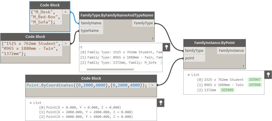

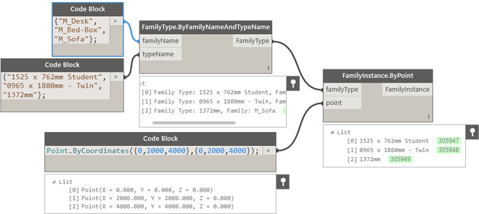

From a list with different names of Components ( [ " chair " , “table” , " sofa " ] ) , I’m trying to insert these components in different coordinates x , y, z ( pt1 , pt2 , pt3 ) .
I know that the node ( Family Type) do this but you have to set the family first. What I want is that Dynamo read the name of the families and then insert in specific places. There is a node that do it? Can someone help me?
