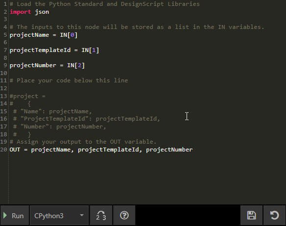

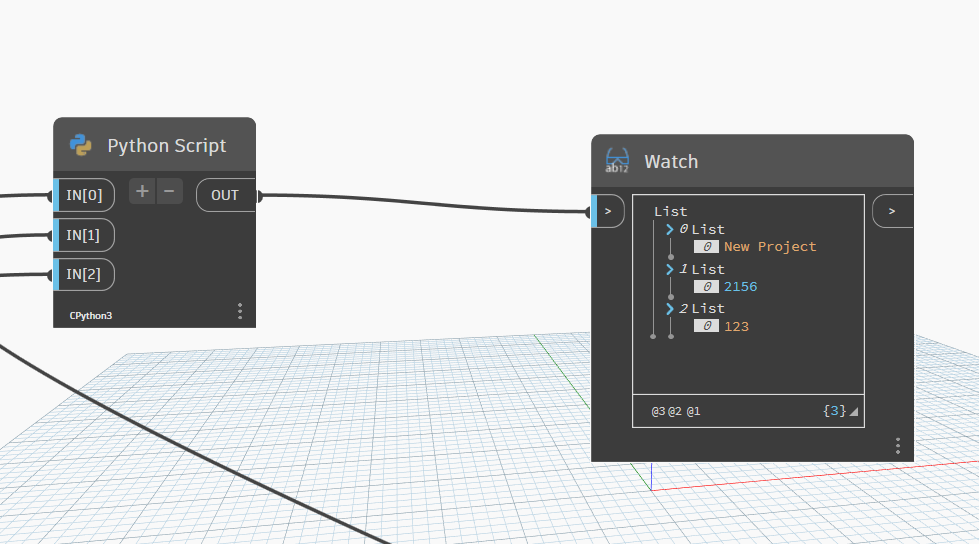

I have got the 3 pop-ups working, and if I do a simple python script to check the outputs after selecting from the pop-ups the outputs are correct (2 strings 1 number)
showing correct outputs
python script that got the outputs above

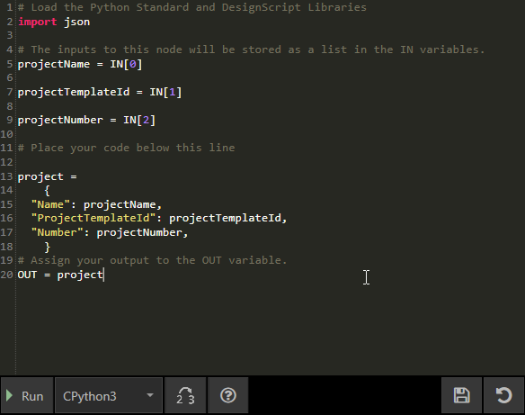

My attempt to convert (concatenate?) in python is below and gives an error
DynamoSandbox_XElSJcfx9F
Error
DynamoSandbox_MGXlBbDO8w
So I tried to improve my syntax with the python graph below, but no luck (and really not a big surprise
DynamoSandbox_1DYSDaIzJe
Which gave me this error
DynamoSandbox_YxSRy0scmf
I’m sure with a little more python research I can get this to work. So I will keep working on my python, but thought I would ask here if anyone has come across a similar issue, and perhaps a solution.
Thanks!

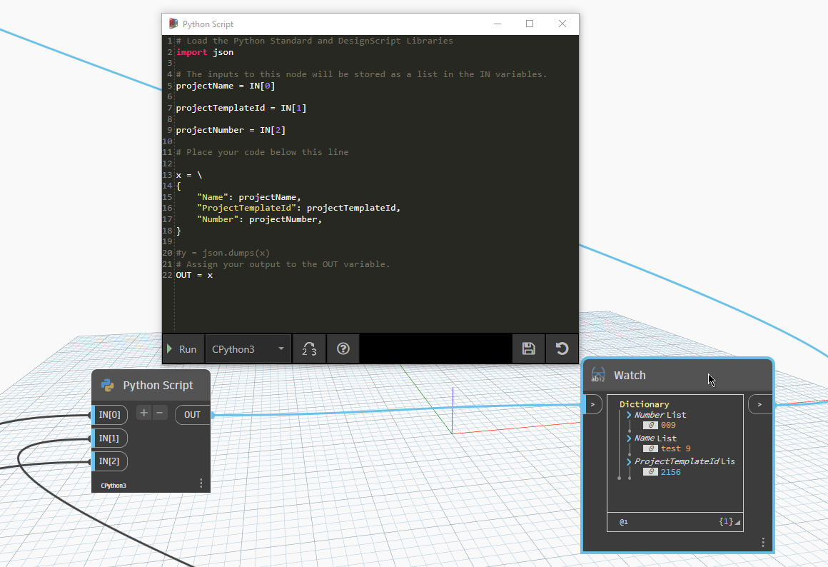

Update!
I tried this script and it worked without error (yeah!) but the inputs are in so list or array out but not the needed string or number (but this info in correct in the square brackets.
Script
DynamoSandbox_8gtzSeRF58
Output
DynamoSandbox_2bRXzmO27a
full output below
{“Name”: [“test 9”], “ProjectTemplateId”: [2156], “Number”: [“009”]}

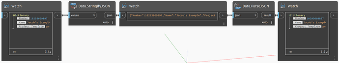

I know that Python was in the title, and there isn’t any problem with this solution, but I wanted to point out that there are also nodes to create JSON and parse JSON in the standard library called Data.StringifyJSON and Data.ParseJSON respectively, which could save some headaches down the line.
These aren’t the newest nodes in the world, but they’ve bene around for a few years at least so you should have them in the 2.13+ build your screenshots are from.
