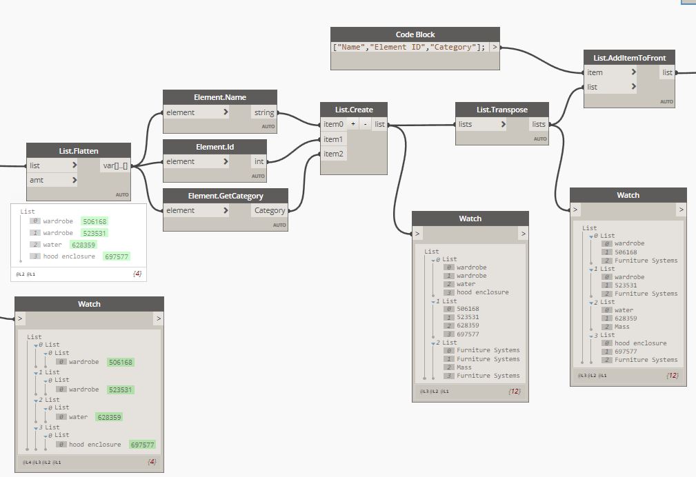

I’m trying to add onto this script - which works well listing the in-place families no problem. I can get dynamo to write the text file but often it is blank or only has 1 listed in place family.
Warning for List.Combine says - “Warning: Combine expects argument type(s) (Function, var…), but was called with (Revit.Elements.FamilyInstance, var)”
I know it is flattening the @level lists pulled by All Elements of Family Type but I’m bad a list management. Any ideas?![List In place families - write file|689x440]
Working on R2019 / dyn 2.0
