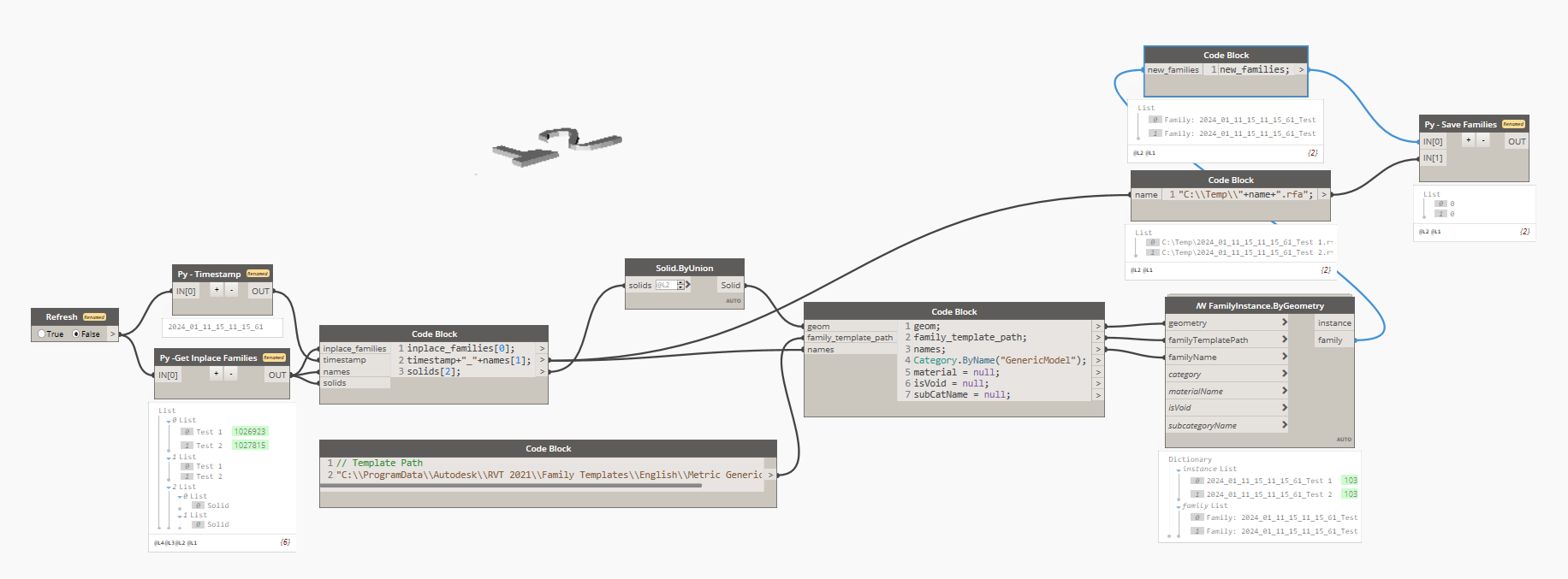

OK I am at a stop I am trying to collect all the in-place families and export them to a folder on the network. I know others have done this, but I am having issues. (I am probably attacking this from the wrong angle. Any help would be appreciated.
Or is there a way to just convert them without export in place with the In Place family name.
So far, I have it collect all the families and gather all the geometry of the families. Now I am at a loss lol.
Attached is the dynamo script
In Place Family2.dyn (21.4 KB)

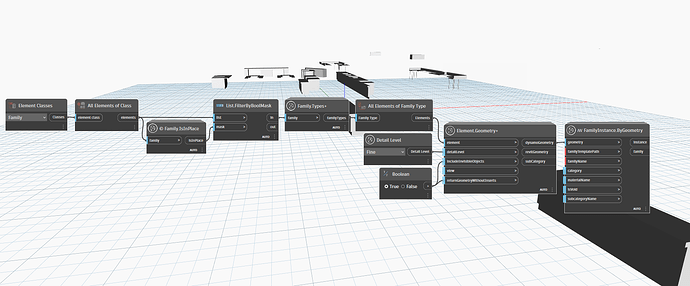

[FamilyInstance.ByGeometry – Dynamo Nodes](FamilyInstance.ByGeometry – Dynamo Nodes)
I know the ol’ give-me-a-button request :sweat_smile:
Getting the families to be created by the geometry can be the tricky part, depending on Revit / Dynamo versioning as there are some known node errors.
Saving out multiple families to a directory is pretty straightforward and has been documented on the forum previously.
Here is a worked example. :wink:
Convert InPlace Families to Family Instances Workflow Example.dyn (29.2 KB)

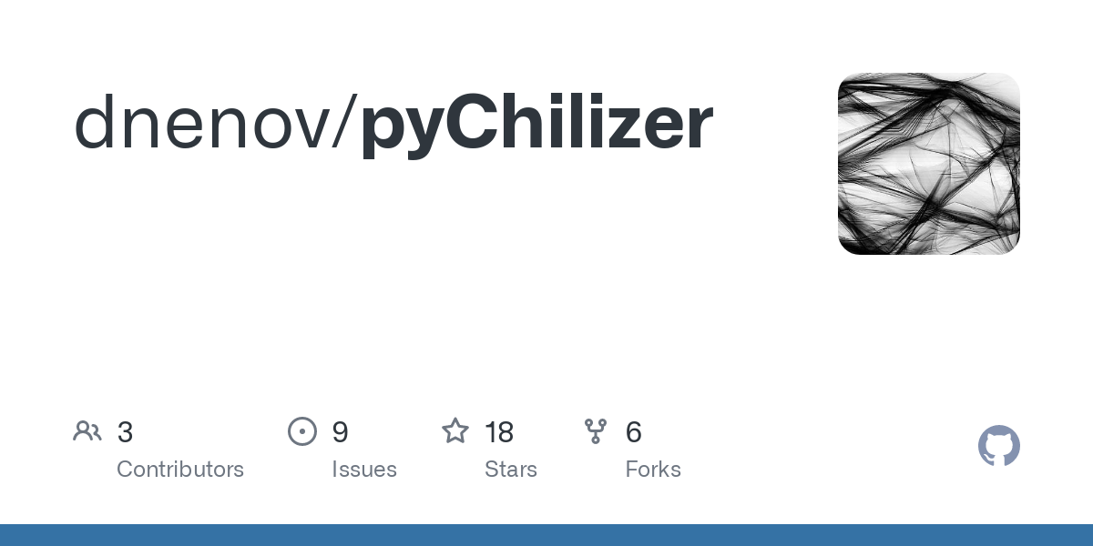

As an alternative, you could with less effort;
-Download pyRevit
-Get the Extenstion “pyChilizer”
A Github for the Author is located here;
The Github link also includes instructions on how to install the extension.
In the families portion there is a pushbutton for inplace to loadable families.
Worth a try, i don’t use it myself but i know that is exists
I use pyrevit for my dynamo scripts didn’t know this was an option lol. The tool works perfect I don’t need all of the other ones that come with it. Wish I knew how they made it.
It does everything I need creates a Generic family over the other one (doesnt delete it just incase) Names it what the In Place family is.
I am going to keep plugging to try and replicate the InPlace to Loadable. Thanks for getting me going again I was about to give up.
